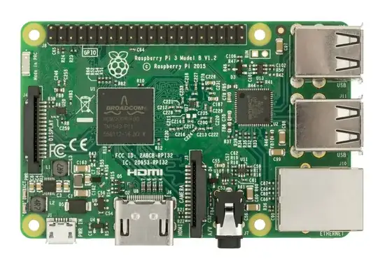

You shouldn't. That's the chip for the original Raspberry Pi.
  1. Make sure you have a Raspberry Pi 3. Compare yours to the picture below. Check the markings on the chip and the PCB. enter image description here
  2. The output from cat /proc/cpuinfo will also tell you how many cores you have. RPi3 has 4 cores.
  3. You could have an outdated OS that doesn't have the proper drivers for the CPU, causing it to not getting recognised properly. Which version of which OS are you running? Where did you get the installer from?

  • @tlhIngan Yes, this is a Pi3 I purchased last week from Amazon; the vendor was Prestige Milano: link. It matches the picture above; the chip was stamped BCM2837. I have run 'sudo apt-get update' and 'sudo apt-get upgrade' several times. When I run 'cat /proc/cpuinfo' I do see information for four processors (0-3). I got the installer from NOOBS. Here is the output from 'uname -a': Linux xxxpi 4.9.41-v7+ #1023 SMP Tue Aug 8 16:00:15 BST 2017 armv7l GNU/Linux. Do you have any other suggestions? – D. MacGrouther Nov 12 '17 at 04:44
  • @Milliways No, but this guy did --> https://www.raspberrypi.org/forums/search.php?author_id=232598&sr=posts&sid=b965706dbd210c3b33a91c3566c08a1e , says it's a 32-bit mode issue. – tlhIngan Nov 12 '17 at 04:44
  • @D.MacGrouther It's likely a legit Pi 3, it's just the OS drivers aren't recognising the CPU properly. – tlhIngan Nov 12 '17 at 04:45
