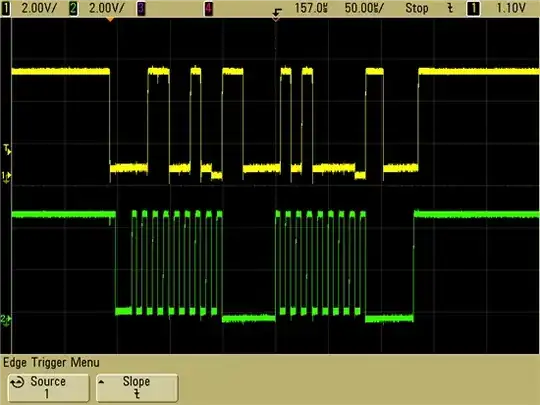

Failing that if you have access to an oscilloscope you can monitor the pins and run i2cdetect again. You are looking for the voltage level to pulse a digital sequence between high (3.3v) and low (0v) on both pins.
