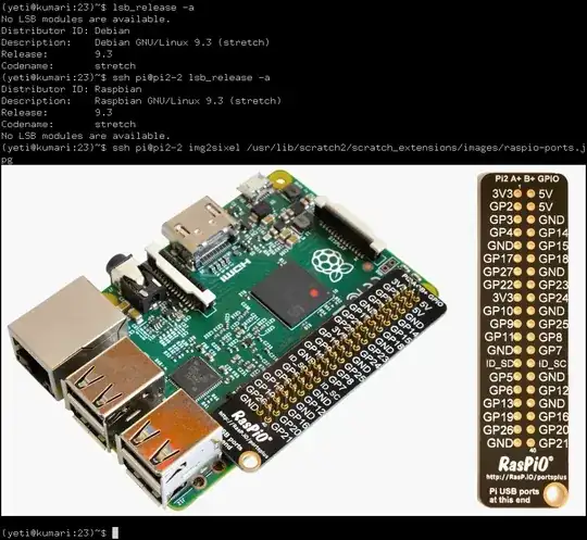

Displaying a picture via ssh taken literally:
Install libsixel-bin on the PI and use a sixel enabled terminal on the PC. Debian's XTerm can do this, so probably Ubuntu's XTerm too.
Add this to your $HOME/.Xresources on the PC:
XTerm*decTerminalID: vt340
XTerm*numColorRegisters: 256
Sixel over SSH
More info about Sixel stuff is at github.com/saitoha/libsixel.
