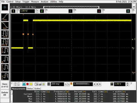

I am working on a problem that seems to be fairly popular with the Raspberry Pi community. In essence, I am designing a circuit that will utilize a DS3231, a 555 timer, and a load switch to cut power from the pi when it is off as well as schedule the next time power will be re-applied.
On to my point, How long do I need to wait after a sudo shutdown -h now to safely pull power? I am determining the time delay of a 555 timer to propagate the low-going edge of a GPIO pin to the enable of the load switch.
I have also read about the UART TX pin being active in certain states of the OS, namely a halt where the SD card might still be doing something but an active high GPIO might already be pulled back low again. I can't find anything about that right now to figure out if I can leverage this as a final check.
