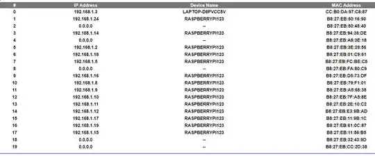

Both networks are available and since NETGEAR30 has a higher priority, the raspberry Pis are supposed to connect to it on startup. However, at startup, some cameras connect to the other network (S.A.L.'S). The NETGEAR30 has a good signal strength so I believe thats not the issue. About half of the cameras connect to NETGEAR30 and the other half connect to S.A.L.S. Upon restarting the cameras, the distribution is somewhat different. For some reason, I can not delete SALS network.
I need help as to why not all 24 cameras are connecting to the router. Is there any limitation?
The output of the netgear router connected IPs are shown below. Notice some of the IP addresses (0.0.0.0) and the device name --. The MAC addresses are the ones for Raspberry Pis.
