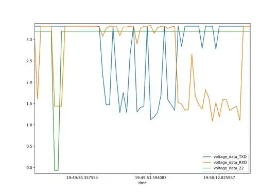

To flash the SleepyPi (ATMEGA328P) I have to pulldown the GPIO 22 from 3,5V to trigger the reset line for the bootloader to accept my code on the UART bus of the Raspberry Pi.
When I run the flashing standlone (-> e.g. the code in the Github) I works flawlessly and the Voltages of the pins looks like this: Flashing standalone
Notice the green line that goes from 3,3 to 0V.

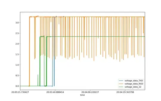

When I run the same code within a the larger Architecture of the my IOT Sensor (which obviously does a lot of other stuff), the GPIO unfortunately does not reach 3,3V but just 2,4V so the reset line doesn't trigger and I can't flash.
Flashing in the larger SW architecture
Notice the green line only reaching 2,4V. Also the GPIO pins for the UART bus still reach 3,3V.
Any ideas on how to solve this?

My best guess from the information you've provided is that you've overloaded (i.e. drawing too much current) that individual GPIO pin, OR you've exceeded the cumulative current limit for all GPIO pins. It's my understanding that the max. current all GPIO pins can source is limited to 50mA as this is the limit for the RPi's 3.3V supply. Assuming that's true, your problem may be due to loading on other GPIO pins, or if you're using the RPi's 3.3V supply to power external circuitry.
The key to your problem is this statement from your question:
"When I run the same code within a the larger Architecture of the my IOT Sensor (which obviously does a lot of other stuff), the GPIO unfortunately does not reach 3,3V but just 2,4V..."
And so it seems likely that your "larger Architecture" is drawing too much current from the RPi's 3.3V supply. Fix that, and I believe you'll fix your issue.
