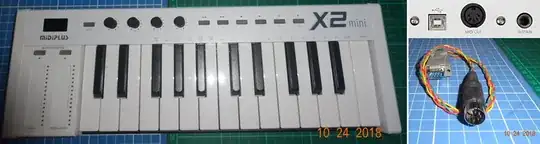

  4. Midi devices use a very old style 5 pin UART like connector for serial communication, so Rpi UART should be able to talk to a Midi device (but with some modification, because Midi UART is not pure UART). I have a MidiPlus X2 Mini and found it quite "portable". There are python Midi libraries available. I tried the beginners ones and found them OK. You may find the referenced video showing the USB and serial connector sockets at the back of the keyboard.

  4. MidiPlus X2 mini Keyboard Controller
    MidiPlus Mini X2 Keyboard Controller
