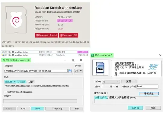

Let me show you as an example, the screen capture of my creating the stretch 2019apr version of SD card image for Rpi.
Win32DiskManagerV1.0
The above picture shows how to create the SD card image for stretch version 2019Apr (downloaded from Rpi's official download site).
I am using this picture as an example to show that you can read the SD card image copied using Rpi SD Card Copier, into a Windows file, named, say "myRpiImage.img".
You can then place this PC Windows Win32DiskMan compatible image file in a safe place, like a locked safe, physically in your home/office, or virtually in the cloud.
Moreover, you can use this read by SD Card Copier image as the master, to create more working copies, or backup copies, using Win32DiskManager.
The advantage of using DiskManager here to make more copies is that you can use SHA256 hash to verify the copies you make are very safe.
This way you can also pretend that you are no ordinary newbie, because you can duplicate Rpi SD card images with SHA256 security (not like other ordinary newbies do, using Rpi SD Card Copier).

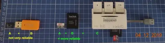

Use MicroSD Adaptor for the Micro SD Card for safer reading/writing and stupid human handling
I found using microSD copier not very reliable, because it has short and too close gold fingers which easily make poor electrical contacts (often you need to try a couple of times to make sure the very small card/writer is properly inserted). I usually use an SD card adapter to "expand" the Micro card to standard size big card, and the reading/coping is then more reliable.
Use SD Card Formatter to make a safer, more reliable copy
I often find micro SD cards intermittently fail to start, or making errors in the first couple of seconds. I usually use SDFormatter to format the SD card first. This way I found less intermittent failing starts.
