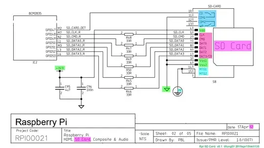

So I googled schematics, and found the following looking good. :)
