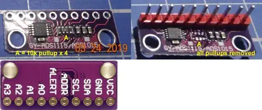

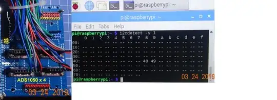

I am testing 4 ADS1015 at the same time, so I need to remove all the I2C pull ups in the modules, otherwise the Rpi I2C circuit will be overloaded and cannot detect the modules.
Then I use i2cdetect command to detect the modules.
Then I wrote a little test program to do just one simple thing - read the register "Wo am I".  The full listing with sample output of the Minimal, Complete, Verifiable program is as below.  You just plug and play, no libraries are required.  One minor thing is that I am using Chinese Windows and there might be funny characters here and there, now and then.  In case you have problems reading my file, try the PenZu backup below.
