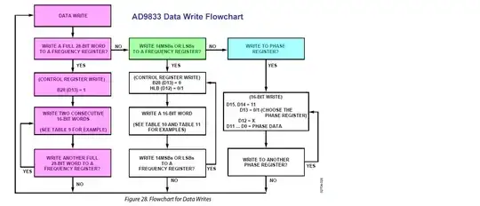

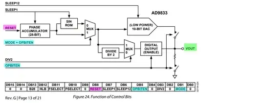

I also study the timing requirements, particular the fsync thing. I found that the minimum requirement is of the order of 5nS, which is nothing if my SPI speed of 400 kHz and output frequency 20 kHz are so low. So I should ignore fsync for my Micky Mouse Midi controller project.
fsync timing
ad9833 control reg
ad9833 data write
