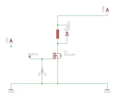

Easiest for one direction is to use a logic level mosfet. No resistors needed
Here is a basic circuit from the ardiuno.cc forums
The IRLZ44N may be overkill for your motor, but still isn't very expensive and will work ok even if the motor is stalled. Also remember that the stall current might be 10A or more.
Many of the cheaper/less powerful parts are surface mount.
The diode(D1) is there to prevent the back EMF from the motor from damaging Q1
The resistor(R1) is there to make sure the IRLZ44N is turned off if the signal is floating. I'm not sure what the GPIO startup state is - the resistor may not be needed.
If you want to be able to reverse the motor, you should use an H-Bridge
As you go to higher power motors, you will find that big mosfets have less sensitive gate, so you'll need a driver between the GPIO and the gate to make sure the mosfet is turned on hard enough
