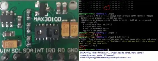

(1) Suggest to check I2C wiring and use "i2cdetect" and "i2cget" to find max30100 chip at I2C Bus #1, I2C device address 0x57, and Part ID 0x11 or 0x15 at max30100 register address 0xFF, as show below. (Note: MAX30100 Part ID is 0x11, MAX30102 is 0x15)
max30100 read
(2) The OP's Test Results
op test results
(3) Using max30100's library methods to read PartID register OK.
read part id reg

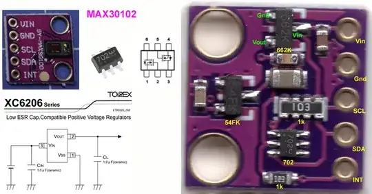

(4) What sort of power supply should be used for the MAX30102 Board?
When I first read the MAX30100 board schematic, I was confused about the 6 pin component marked in Chinese "Input 1.8V to 5.5V". I googled around and found users claiming different things, from the board is wrong, to how to removed the 4k7 pullup resistor external to the board and connect them to 2.8V or 3.3V. It is only after I figured out why there is a 6 pin voltage regulator then I realize what should I do, like (1) Should removed the 4k7s out and connect to 2.8V, or 3.3V, or even 5V, if I am stepping up Rpi I2C signals from 3V3 to 5V, ...

Fig 4 - GY-MAX30102 Module Schematic
max30100 schematic

Fig 8 - MAX30102 PCB and Components Layout
max30102
Fig 9 - MAX30100 Module Voltage Input Vin = 1.8V to 5.5V
max30100 module Vin

I was told by Maxim tech support that if you are not using the INT pin your data will be fluctuating wildly - i.e. - inaccurate
you MUST use the INT to tell the program when the FIFO registers are ready for you to collect (accurate) data
