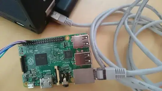

Next, boot the Pi, and link an Ethernet cable from your laptop directly to the Pi:

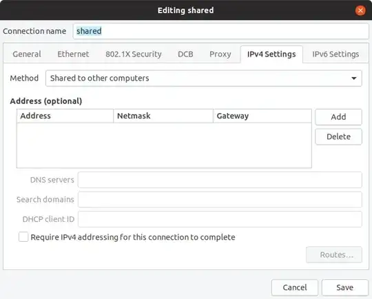

On the host, open the network manager:
nm-connection-editor
And go:
+ sign (Add a new connection)
- Ethernet
- Create
- IPv4 Settings
- Method: Shared to other computers
- Set a good name for it
- Save

The crossover cable is not required if the host network card supports Auto MDI-X. This is the case for most recent hardware, including for example the 2012 Lenovo T430 I tested with, which has an "Intel® 82579LM Gigabit Network Connection" which documents support for Auto MDI-X.

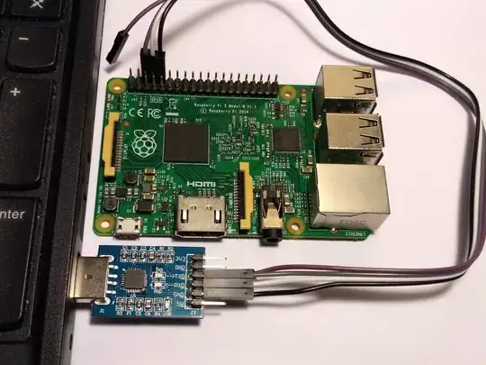

Now connect your computer to the Pi as:
You only need to attach 3 cables:
- Ground to Ground
- Tx on Pi to Rx on the USB to serial port
- Rx on Pi to Tx on tye USB to serial port
This is also documented at: https://www.raspberrypi.org/documentation/usage/gpio/README.md
Be careful not to link the Ground to the 5V, I've already burned 2 UART to USB chips by doing that!
You don't need to connect the 5V to the 5V at all. I think you can power your Pi like that, but I've read that this is a bad idea, just use the usual USB power source.
