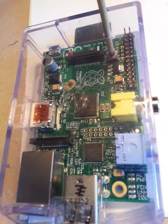

I've used that shutdown.py solution too.
You'll still need to find a physical switch and solder it to pins 6 and 8 of header 5. I took mine from an old broken Arduino board. I've also drilled a small hole in the case to make sure that I can push the button with a small wooden pin when the case is closed.
This is how it looks like:

As a Raspberry Pi newbie, why is it necessary to find a physical switch and solder it to those pins? Do you need hardware to turn it off properly, or what happens if you just turn it off by using software (i.e. from the shell or from a GUI)? – HelloGoodbye Jun 29 '19 at 16:55
2The point was to do it locally without remote access. There is no button that would gracefully shutdown OS, so just "pulling the plug" as OP has suggested is not a good option. – Oleg Gryb Jun 29 '19 at 17:35
I’m not sure I follow you. Why is a physical switch soldered to the Pi necessary, or even better than pulling the plug? – HelloGoodbye Jun 30 '19 at 19:32
1No, you're definitely not. I'm not saying that "it's necessary", I'm saying you can use the solution to shutdown the device gracefully without remote access. – Oleg Gryb Jun 30 '19 at 19:36
Ah, I get it, so it’s only necessary if you use the shotdown.py solution. The file seems to have been moved or removed, though; your link doesn’t point to it anymore. – HelloGoodbye Jul 01 '19 at 06:18
