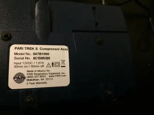

I recently bought a compressor and now I want to be able to turn it on and off programmatically using my Raspberry Pi Model B.
Since I know nothing about electronics, it seems like the safe option would be to do to not mess with mains power but to switch the power on or off after the adaptor where the voltage is lower.
This is the adaptor:
Power adaptor
And this is the sticker on the compressor:
Power adaptor
Assuming I'm a programmer who knows nothing about electronics, how can I switch the power on or off using Python or preferably C on my Raspberry Pi?
PS. I don't mind the cost of buying equipment. If there's a solution that costs more but requires less work, that is preferable.

You'll need just two things:
Make use of the GPIO pins
Using the GPIO port of the Pi is possible with numerous libraries for all significant languages. Finding one that interfaces well with Python or C is no trouble at all. Just have your pick, e.g.
Use a relay to control the 12V power line
A simple transistor is sufficient to drive a small relay from the Pi's GPIO pin. Just pick a relay that supports more than 2 A, but that should not be a big deal. Or go for one of the custom addon boards for the Pi, e.g. the PiFace.
Ghanima
  • 15,855
  • 119
