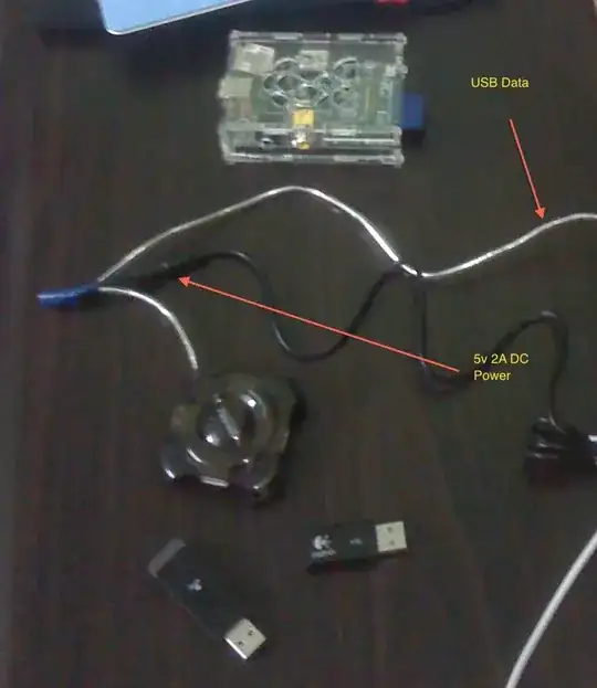

I have put together a DIY External Powered USB Hub by following the instructions. (Instructables, htc-linux)
  • USB hub with 4 ports
  • 5v 2A AC/DC power supply (It varies when tested with multimeter, 5.3 ~ 5.5)
DIY hub
Unfortunately it doesn't seem to work. Here is the lsusb -v I try plugging Logitech K260 and Netgear N150 - WNA1100 wireless adaptor, nothing was detected when connecting via Hub. I couldn't figure the issue, I tested for the connectivity of of the 4 points (+5 D+ D- GND), seems to be working.
I would like to use my Netgear N150 instead of LAN cable. Though it is detected if connected directly, it doesn't connect. I assume it is due to power requirement, it is the reason why I built this USB hub in first place.
Here is the output from lsusb -v

[  340.933405] hub 1-1:1.0: connect-debounce failed, port 2 disabled
[  343.493475] hub 1-1:1.0: connect-debounce failed, port 2 disabled
[  346.053492] hub 1-1:1.0: connect-debounce failed, port 2 disabled
[  348.453463] hub 1-1:1.0: connect-debounce failed, port 2 disabled

palaniraja
  • 173
  • Anything reported by dmesg? – Jivings Jan 06 '13 at 18:08
  • @Jivings updated the question with dmesg output. – palaniraja Jan 08 '13 at 02:42
  • hub 1-1:1.0: connect-debounce failed, port 2 disabled: This almost certainly represents a power issue. – Jivings Jan 08 '13 at 09:02
  • any resources to understand more about the issue? – palaniraja Jan 08 '13 at 09:06
    You were supposed to solder the power on the PCB - Not mid way on the USB wire. That just causes serious issues with Data because you mess with the shield and cause noise that is not expected. Does it work in windows? If not. Bin it, thats your lesson learnt and paid for. Then, do it properly...(I suspect there are diodes missing also.. ehh) – Piotr Kula Jun 06 '13 at 08:26
  • I'm using a 7 port external powered usb hub. I cut the 2 data wires from the power cord and the 2 power wires from the usb->raspberry cord. With windows the hub works fine but with the rasp I have a lot of hub 1-1:1.0: connect-debounce failed, port 2 disabled As said before, cord modification could be the problem? – Mcgyver83 Feb 01 '14 at 11:02
  • as long as I know you dont cut BOTH power cables. To create a communication you need a common GND – javirs Mar 03 '14 at 13:20
  • @AwesomeUser done. I ended up buying a external powered USB adapter as my DIY failed. And I accepted an answer closer to the one. – palaniraja Mar 31 '14 at 05:39
  • WNA 1100 is highspeed(480 mbps) usb device. while the hub might be a full speed device(12 mbps) try lsusb -t option Also tail /var/log message while connecting the usb device –  Sep 15 '14 at 16:47
It may be over voltage. When they say the USB spec is 5 V it's usually much closer than 5.3. The fact that the power supply ranges so much isn't a good sign. It could be causing continued resets on the Wi-fi or activating its over-voltage protection. Try to see if you can clean up the power-supply's output some (or try a phone charger temporarily?). A 5 V Zener diode should protect more from the over-voltage at least.
Fred
  • 4,552
  • 29
  • USB spec is pretty clear about this: 5V line should be between 4.75 and 5.25V, anything substantially out of this range (like 5.5V) is asking for trouble. – Dmitry Grigoryev Apr 04 '17 at 14:08
Manipulating the usb cable is not a good idea, as, in consideration of the high frequencies involved, it must be considered a transmission line (*) to all effects: in the best case (i.e. very very very clean work AND very very very good luck) you get some performance downgrading. It is possible that you got nearer to the worst case than to the best one.
The htc-linux procedure seems more reliable than the instructables one. Of course in the framework of a very very very clean work.
(*) Note: the key feature of a transmission line is translational symmetry. Any symmetry breakdown causes signal reflections.
stemicc
  • 46
Not sure if this would help, but this one is the most pathetic USB hub that one can get. I had to discard two of these before I switched to a better one, and voila! everything worked! So, try replacing this (such) hub with a better one, and see. Also, you might want to plug-in the WiFi adapter directly to Pi, and use this hub for other miscellaneous devices with lower power requirements. I assume the wireless mouse requires much less power than the WiFi adapter.
pugmarx
  • 111
  • Yes wireless keyboard/mouse require only 96mA and wifi needs only 500mA. I have replaced the usb to go with 2A adaptor to rPi. But having issue with driver now - http://raspberrypi.stackexchange.com/questions/4687/setting-up-netgear-n150-usb-wifi-adapter-with-raspberrypi-wheezy – palaniraja Feb 05 '13 at 09:24
