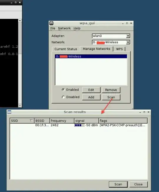

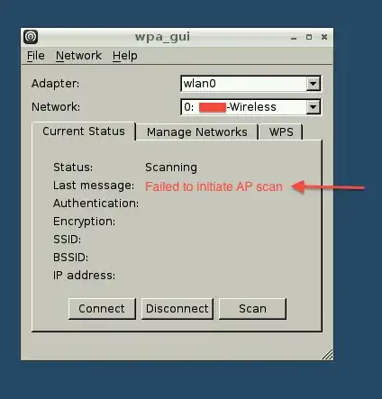

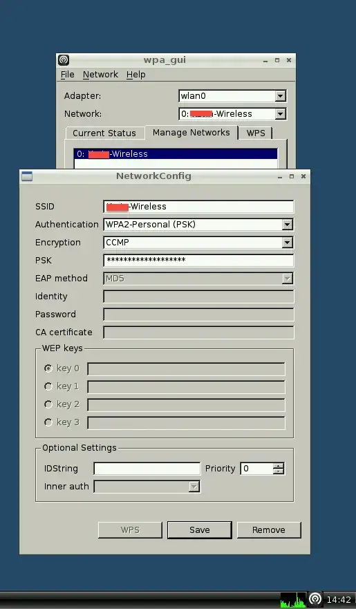

Though power seems to be not an issue anymore, I can scan for network and configure, but i was not able to connect to my network. When I tap on connect, i can see 'Failed to initiate AP Scan' message in the progress.
Find output of lsusb, iwlist scan and ifconfig below.
Network config
Scanning
Update Feb 22
I couldn't make it to work even with external powered USB hub. Same "Failed to initiate AP Scan" but "Scan" functionality works. Issue is only with connecting to a access point.
My usb wifi adapter
Update Aug'13 2013
Three words NOOBS is awesome. The recent version of Raspbian installed with NOOBS is working out of the box without any additional steps.
Not sure it is the version comes with NOOBS v.1.2 package, I have tried apt-get upgrade to update my installed version of Raspbian and was not successful.
Note: Still It doesn't work with hidden SSID.

  • Launch Wifi connection Gui by typing 'wpa_gui' in terminal (I don't know where the icon is). Selected adapter should be "wlan0", and nothing is displayed in "Network"
  • Click on "scan" in the bottom of the window
  • You obtain a list of Wifi access points.
  • Double click on the name of yours, and enter security settings
  • Click on "Add", close list window
  • It should display "Status : Completed (station)". Click on "connect"
  • Do a "File / Save configuration" (I'm not sure of that).
  • You could now "connect" to your Wifi spot
