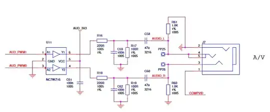

Raspberry-spy.co.uk lists the configuration of the 4-pole A/V jack of the Pi B+ the following way (added testpins PP on the Pi 3 for conveniance, note that according to this and this the same pads are available on the Pi 2B and B+, thanks @mayhem):
- Sleeve - Composite video (PP24, according to Raspberry Pi 3 test pads, though not listed in the official schematics.)
- Ring 2 - Ground (PP6, among others)
- Ring 1 - Audio-Right (also PP26)
- Tip - Audio-Left (also PP25)
Since it features the composite video it is neither OMTP nor CTIA as those would include a microphone instead. Besides that the pin ordering of the audio and GND pins follow the CTIA system.
From the official schematics of the Raspberrypi Foundation (3B_V1.2 and B+_V1.2) we find that both the Pi 3 (upper figure) and the B+ (lower figure) share the same configuration.

1PP24 should be the AV pin, but always measure with a meter or other means first before soldering/using. there are listings on the web to help you narrow down test points.. just always confirm them first. one listing... http://ozzmaker.com/testing-points-raspberry-pi/ – Angry 84 Dec 13 '18 at 07:25
