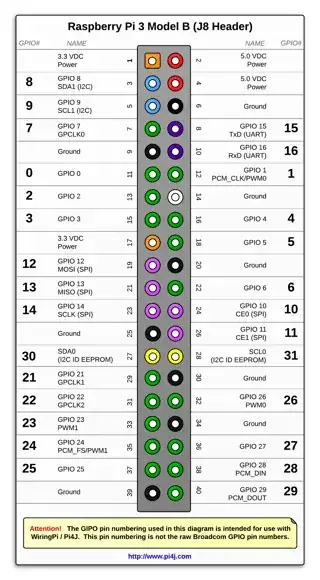

The Pi4J Project - Pin Numbering - Raspberry Pi 3 Model B has a pinout image that mentions:
  • J8-12 GPIO 1, PCM_CLK/PWM0
  • J8-35 GPIO 24, PCM_FS/PWM1
  • J8-40 GPIO 29, PCM_DOUT
Apparently, it mentions the PCM functions of the pins (instead of their I2S roles) - but then, the GPIO numbering is totally different from the previous two examples? Here is its diagram:

So, my questions are:
  • Is there (and if so, where) a definitive pinout diagram, that will tell me which pins on the Raspberry Pi 3 model B J8 40-pin header can I use for I2S?
  • Since the data in/out issue confused me: does I2S have a bidirectional serial data line (i.e. would the same line serial data (SD) be used for both data in from ADC, and data out to DAC) - or are there separate unidirectional lines (e.g. DIN to read data in from ADC, and DOUT to write data out to DAC)?
  • Can the setup of these pins be "seen" somewhere in the source code of Raspberry Pi Raspbian OS? For instance, Device Trees, overlays, and parameters - Raspberry Pi Documentation mentions that a device tree description for usage of I2S would involve a statement like target = <&i2s>; - but where is it defined, that what would correspond to pins J8-12, J8-35 and J8-12, should be setup in a specific manner for I2S, if such a I2S setup statement is present in the device tree? Or is this completely unrelated to the setup of the pins as I2S - and the setup of these pins is elsewhere in the source code?

The GPIO you want are
18 PCM_CLK
19 PCM_FS
20 PCM_DIN
21 PCM_DOUT
No others are accessible from the Pi3B expansion header.
See the PCM/I2S Audio section (page 119) of the Broadcom peripherals document.
