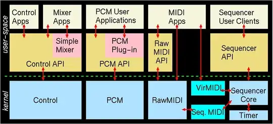

The ALSA sound system
ALSA is meant to support any kind of *nix based device, regardless of its hardware configuration and regardless how old is the hardware. Needless, there is little point in trying to get into the details of 20 years of its development. We simply apply the essence to a current situation.
However, at no time in history has mankind produced such an amount of useless and dysfunctional diagrams, as for trying to explain ALSA. The only ones remotely informative are these two:
enter image description here enter image description here
