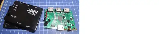

hdmi selector
Long Answer
Suppose you have 3 Rpi's and you wish to select which Rpi to display on the one and only one HDMI monitor, using Rpi GPIO pin to "press" the button, instead of using the human hand to press the button. To do this you need to:
  1. open the box,
  2. find the two contact points of the button,
  3. check the nature of the switch,
  4. if it is a mechanical switch, you can use a cheap Rpi GPIO controlled 5V relay to do the switching. So you can now do both manual and Rpi software select.
  5. I have such a switch, with 5V power input. That means the button controls a 5V high low signal. This is a bit complicated. If the button is a "pull up" type, then you can use one GPIO pin, step up 3V3 logical signal to 5V, and connect to the button pull up resistor contact point, and that is it.
hdmi switch
WARNING: mess around things at your own risk: I don't guarantee your HDMI mon will not explode! :)

My cheapy US$7 HDMI splitter actually IR remote control
HDMI Switch 3 Port Video Splitter 3 In 1 Out IR Remote Control - US$7
hdmi switch
So I think it is much safer and easier to DIY a Rpi GPIO IR remote controller, than to mess around with the electronic button circuit.
